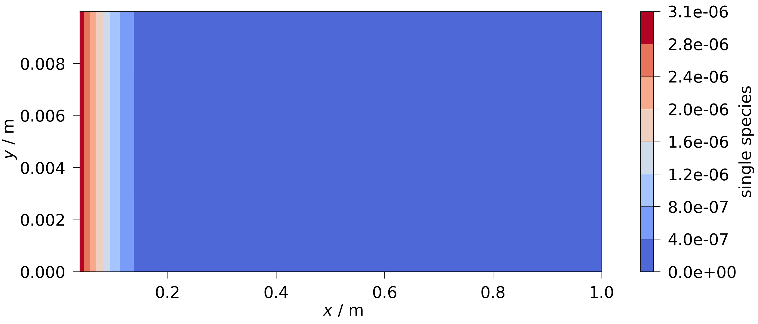

  1. Plot the results.
ms = ot.MeshSeries(temp_dir / "CT_model.pvd")
fig = ot.plot.contourf(ogs_sim_res, "single_species")
fig.show()
plot C feflowlib prj

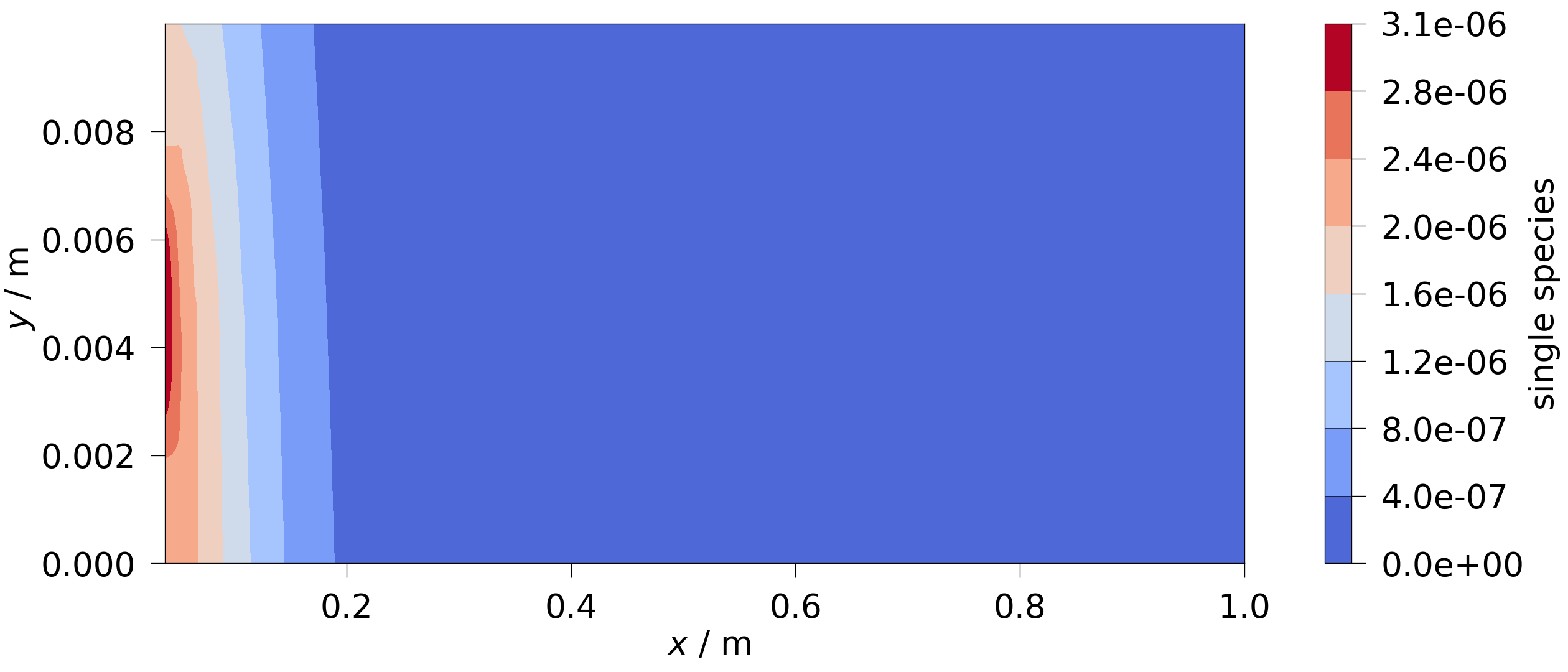

  1. Remove some points of the boundary mesh, which is part of the subdomains.
bounds = [0.037, 0.039, 0.003, 0.006, 0, 0]
new_bc_mesh = feflow_model.subdomains["single_species_P_BC_MASS"].clip_box(
    bounds, invert=False
feflow_model.subdomains["single_species_P_BC_MASS"] = new_bc_mesh
  1. Run the model.
feflow_model.run(overwrite=True)
fig.show()
