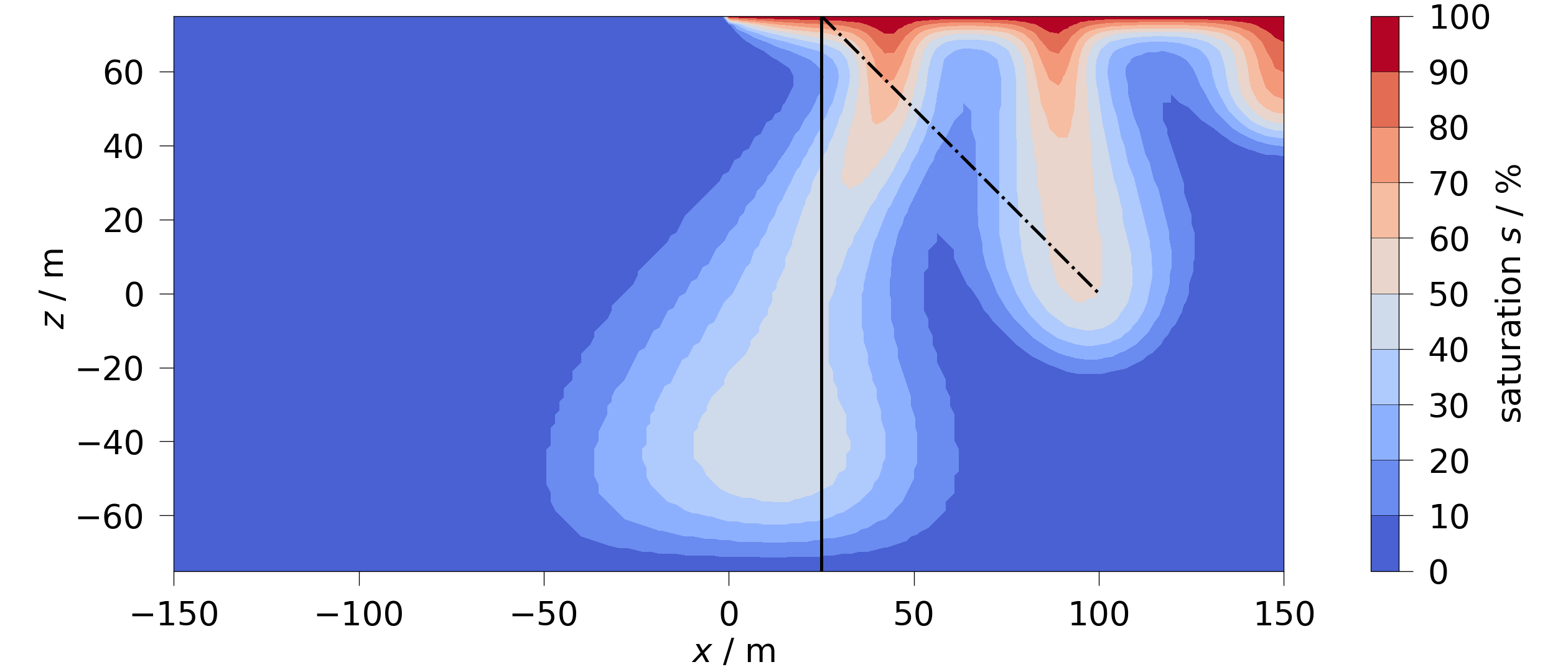

Now we setup two sampling lines.
pts_vert = np.linspace([25, 0, -75], [25, 0, 75], num=300)
pts_diag = np.linspace([25, 0, 75], [100, 0, 0], num=300)
fig = ot.plot.contourf(mesh_series.mesh(-1), si, vmin=0)
fig.axes[0].plot(pts_vert[:, 0], pts_vert[:, 2], "-k", linewidth=3)
fig.axes[0].plot(pts_diag[:, 0], pts_diag[:, 2], "-.k", linewidth=3)
fig.show()

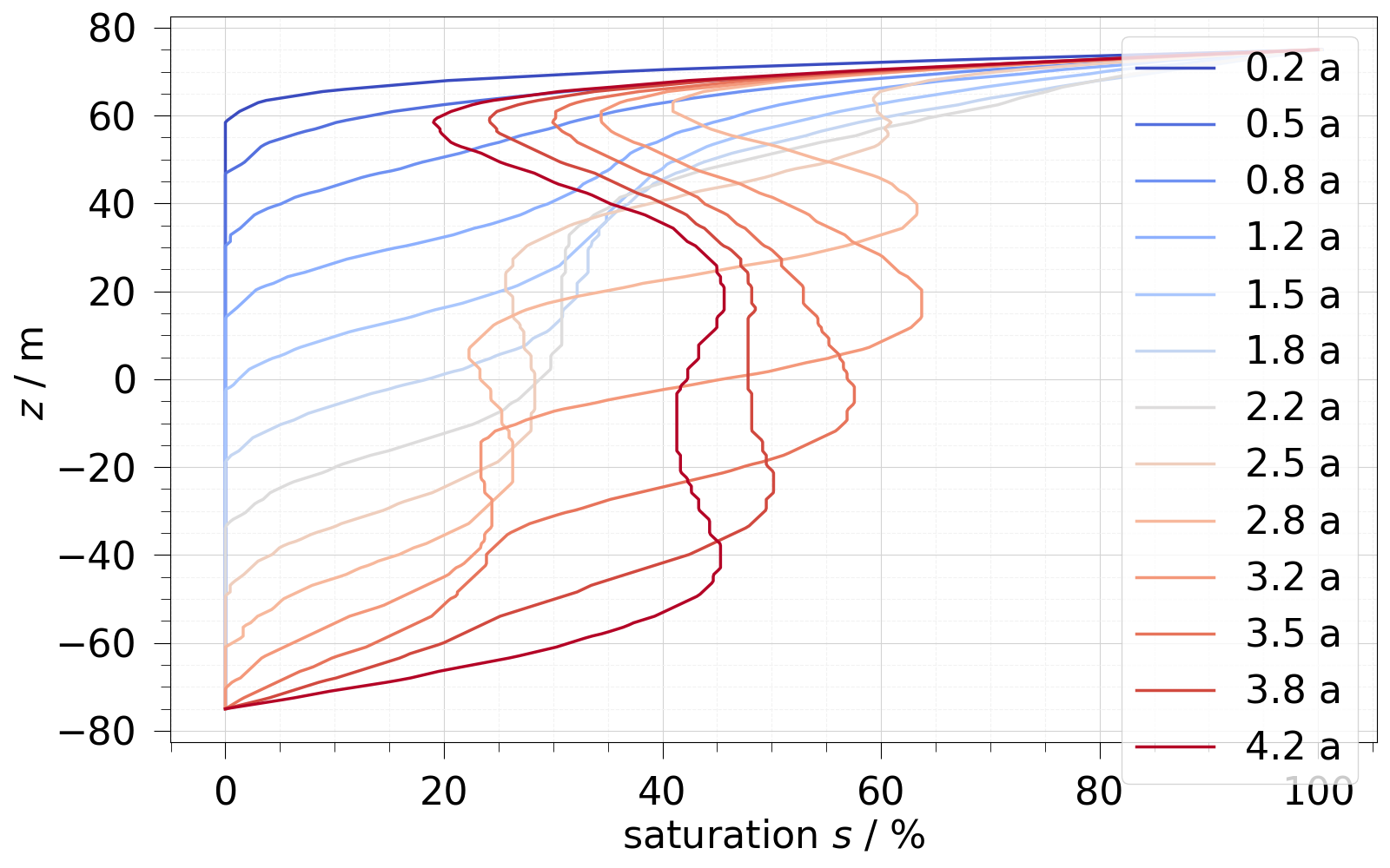

Here, we first show a regular line sample plot for the vertical sampling line for each timestep.
ms_vert = mesh_series.probe(pts_vert)
labels = [f"{tv:.1f} a" for tv in ms_vert.timevalues]
fig = ms_vert.plot_line(si, "z", labels=labels, colors="coolwarm")
fig.show()

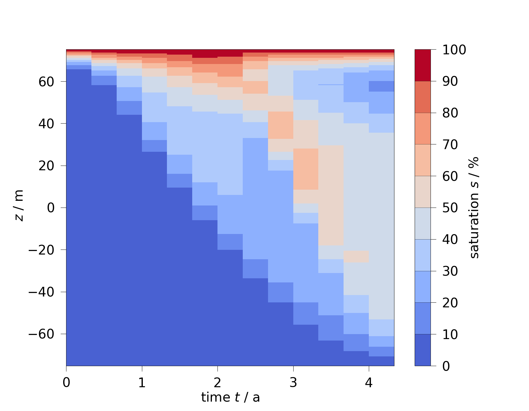

As the above kind of plot is getting cluttered for lots of timesteps we provide a function to create a filled contour plot over the transient data. The function plot_time_slice() creates a heatmap over time and space.
fig = ms_vert.plot_time_slice("time", "z", si, vmin=0, vmax=100)
fig.show()
plot timeslice

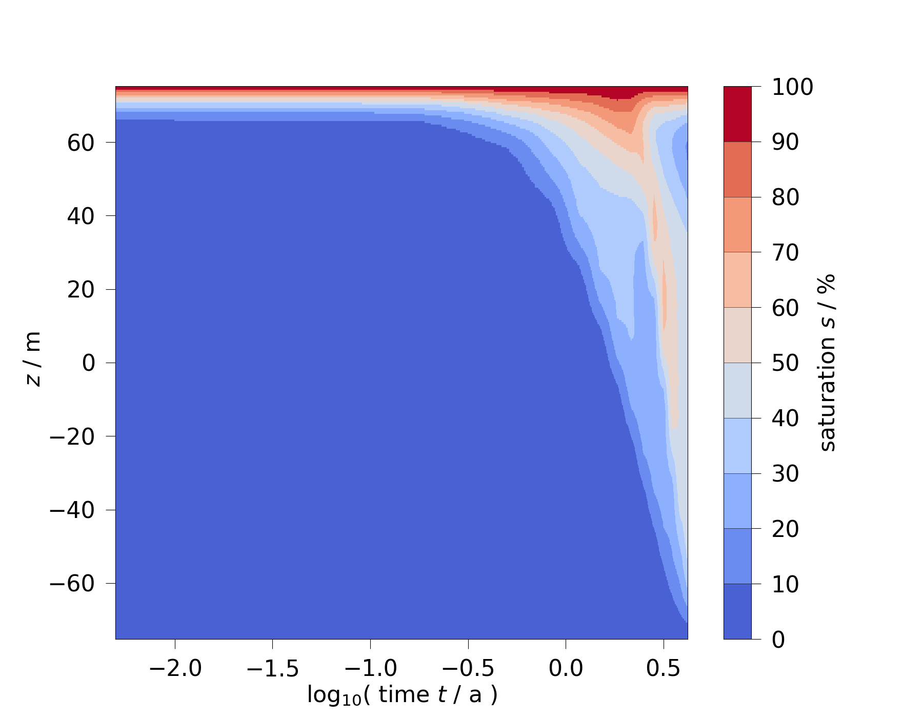

The stepping in this heatmap corresponds to the individual timesteps. To create a smoother image, we can resample the MeshSeries to more timesteps.
ms_vert_fine = ms_vert.resample_temporal(np.linspace(0, 4.2, 300))
fig = ms_vert_fine.plot_time_slice(
    "time", "z", si, vmin=0, vmax=100, time_logscale=True
fig.show()
plot timeslice

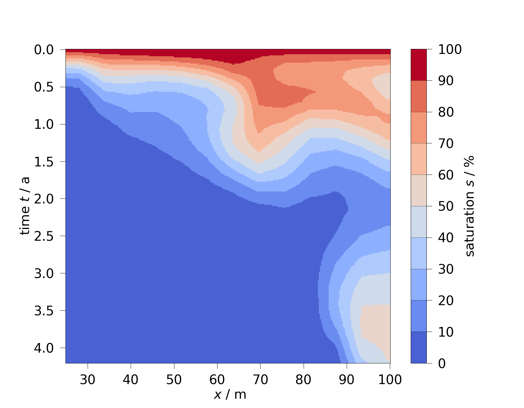

You can also change the order of the arguments for spatial coordinate and time to flip the x- and y-axis.
ms_diag = mesh_series.probe(pts_diag)
ms_diag_fine = ms_diag.resample_temporal(np.linspace(0, 4.2, 300))
fig = ms_diag_fine.plot_time_slice("x", "time", si, vmin=0, vmax=100)
fig.axes[0].invert_yaxis()
fig.show()
