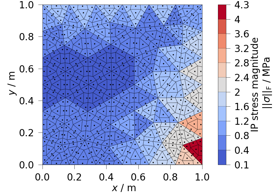

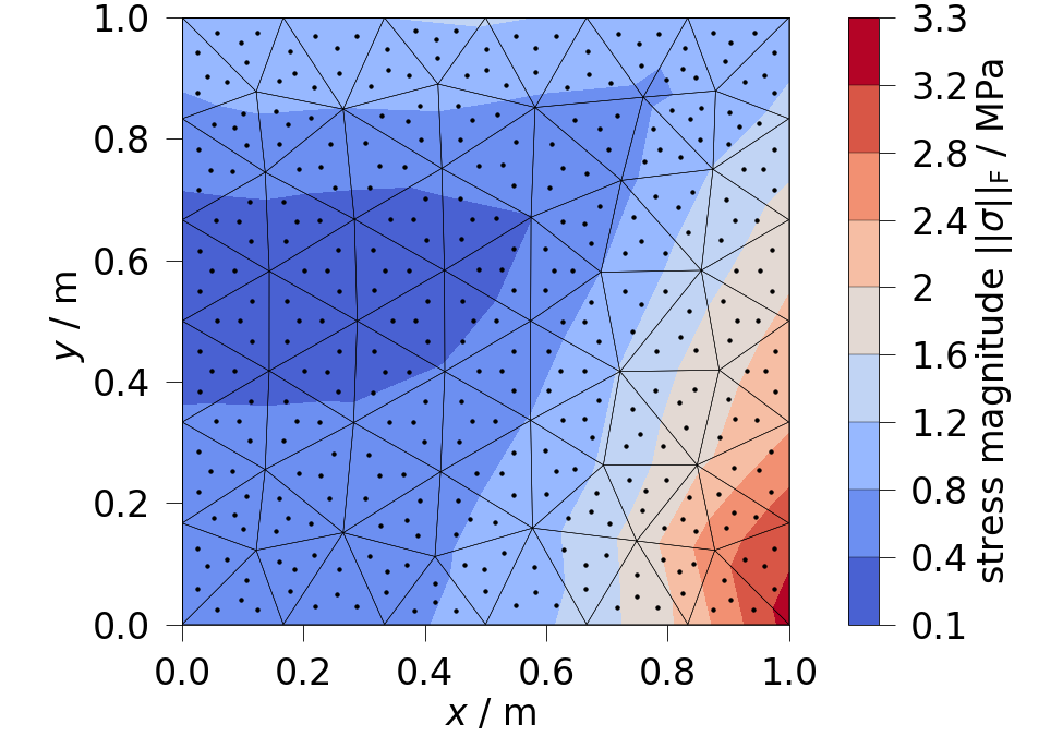

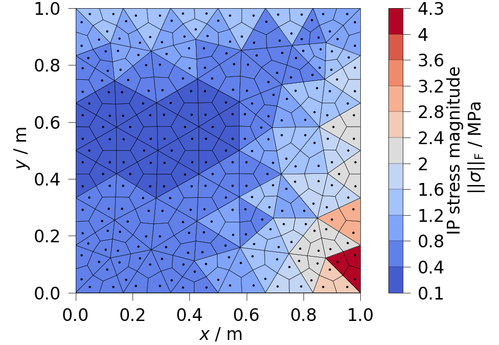

simulate_and_plot(elem_order=1, quads=False, intpt_order=2)
  • plot ipdata
  • plot ipdata
simulate_and_plot(elem_order=1, quads=False, intpt_order=3)
  • plot ipdata
  • plot ipdata
simulate_and_plot(elem_order=1, quads=False, intpt_order=4)
  • plot ipdata
  • plot ipdata

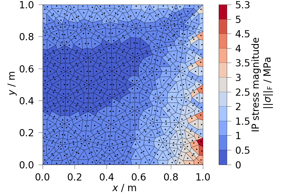

Quadratic triangles#
simulate_and_plot(elem_order=2, quads=False, intpt_order=4)
  • plot ipdata
  • plot ipdata

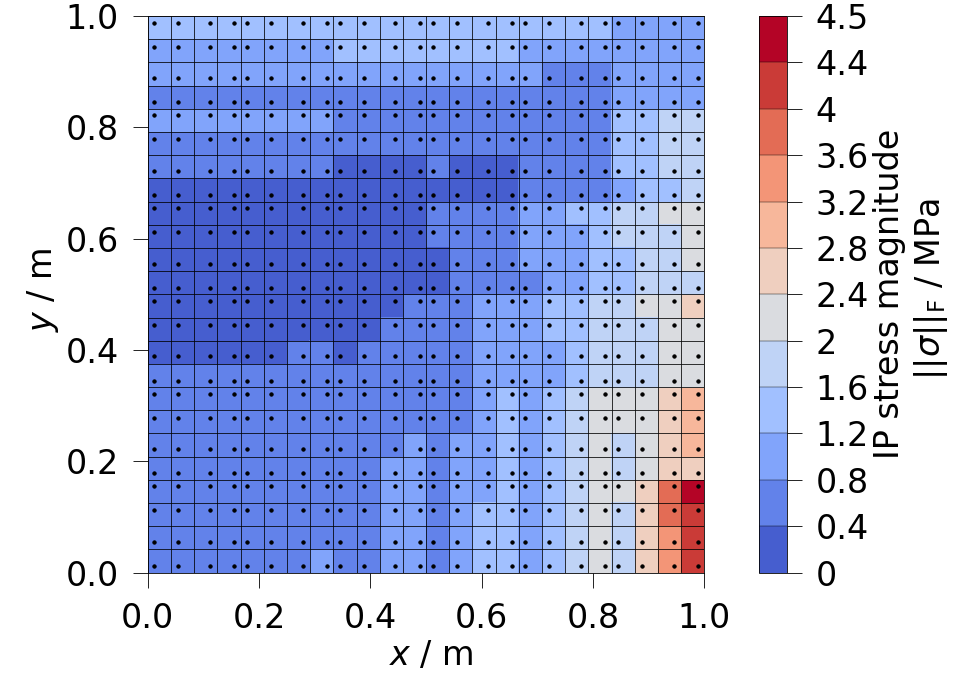

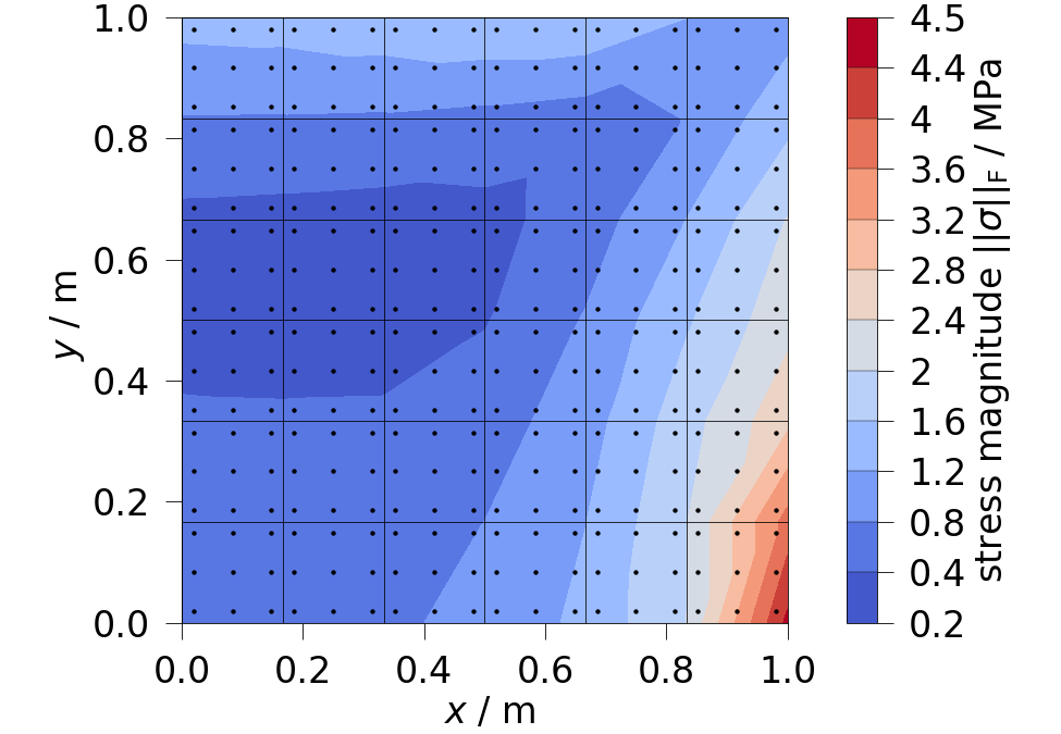

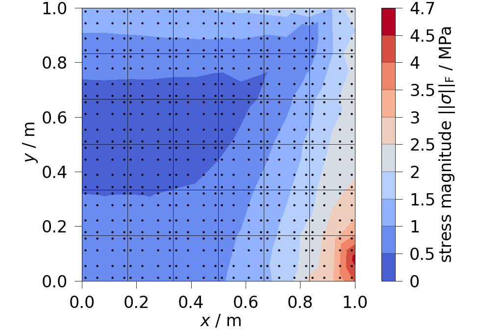

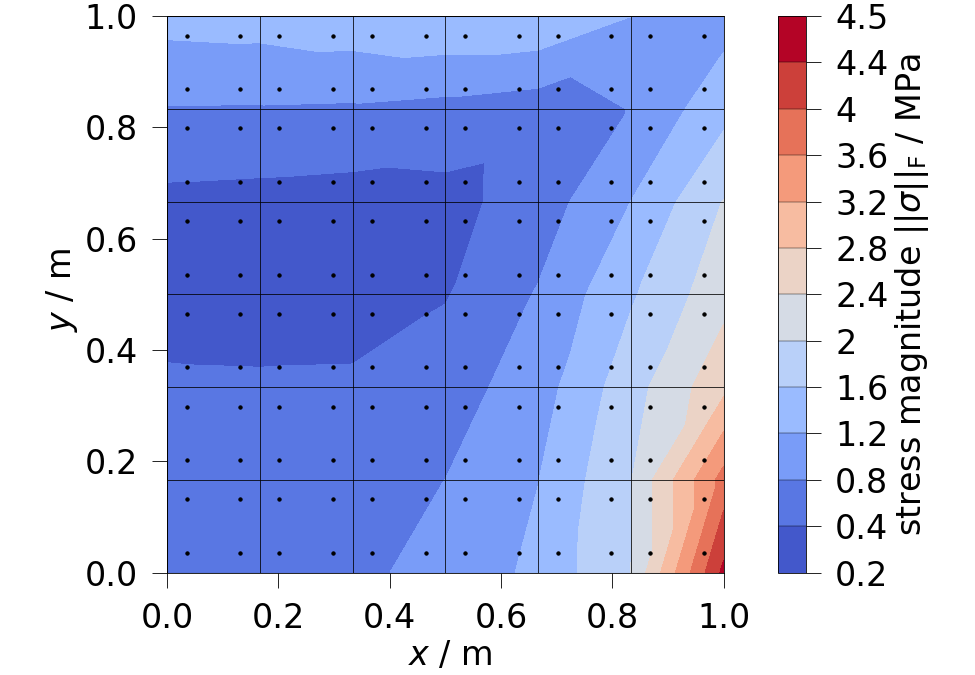

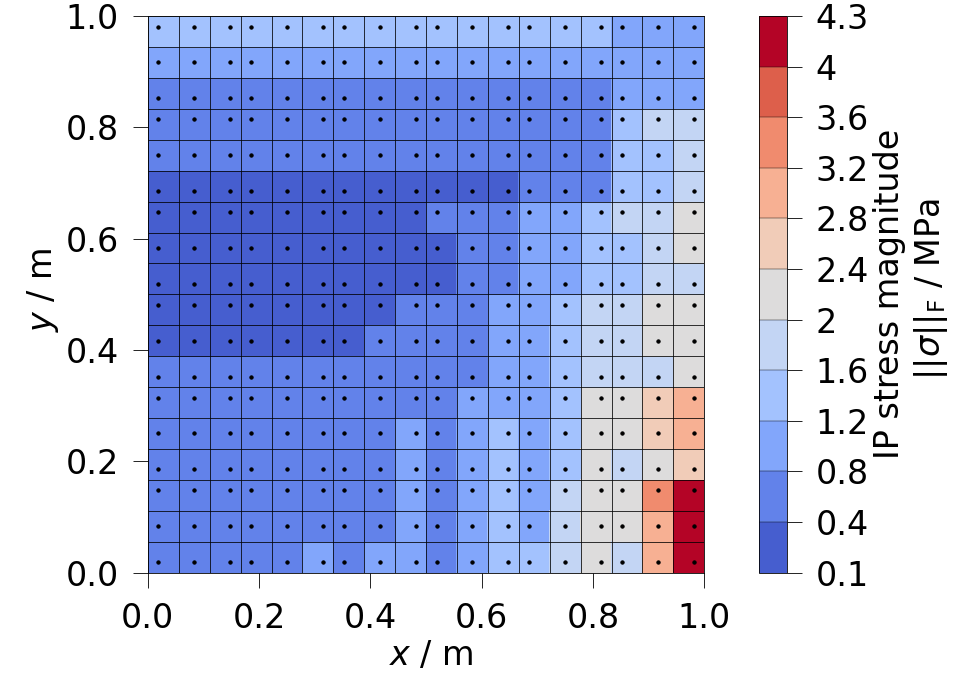

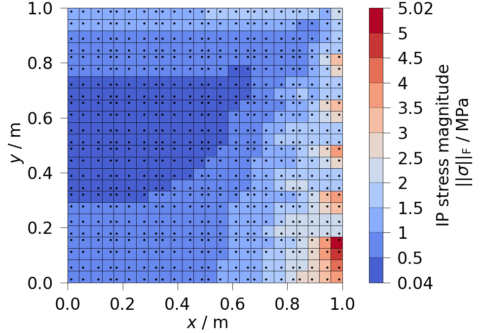

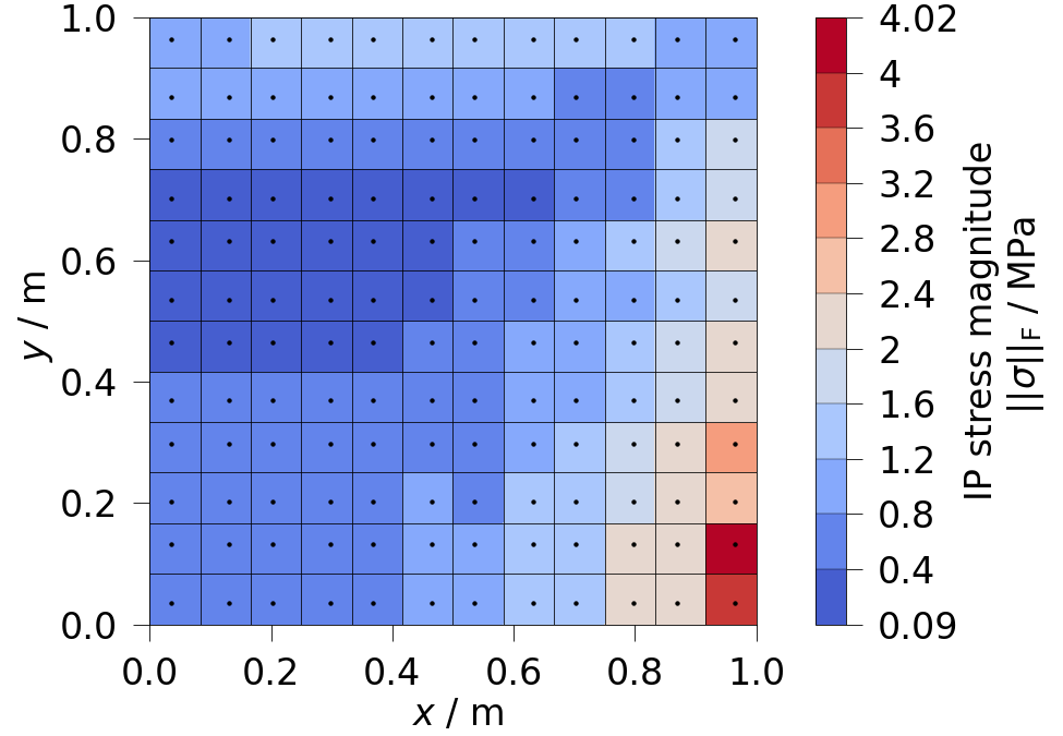

Quadrilaterals with increasing integration point order#
Why does the stress change here?
In contrast to triangular elements, quadrilateral elements use bilinear shape functions. Thus, the differentiation of the displacement leads to bilinear strain. The stress in turn is bilinear as well and can change within the elements. The number of integration points consequently affects the resulting stress field.
simulate_and_plot(elem_order=1, quads=True, intpt_order=2)
  • plot ipdata
  • plot ipdata
simulate_and_plot(elem_order=1, quads=True, intpt_order=3)
  • plot ipdata
  • plot ipdata
simulate_and_plot(elem_order=1, quads=True, intpt_order=4)
  • plot ipdata
  • plot ipdata
