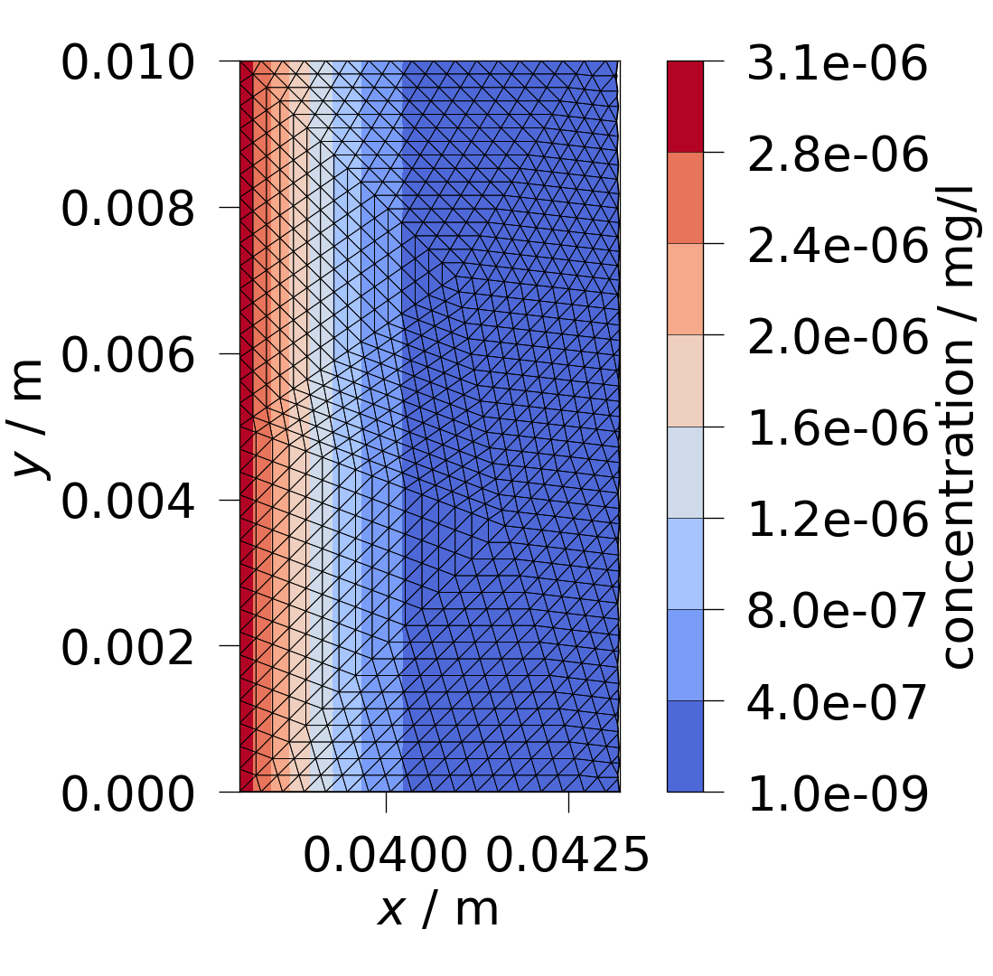

# The original mesh is clipped to focus on the relevant part of it, where
# concentration is larger than 1e-9 mg/l. The rest of the mesh has concentration
# values of 0.
clipped_mesh = feflow_model.mesh.clip_scalar(
    scalars="single_species", invert=False, value=1.0e-9
fig = ot.plot.contourf(clipped_mesh, concentration)
fig.show()

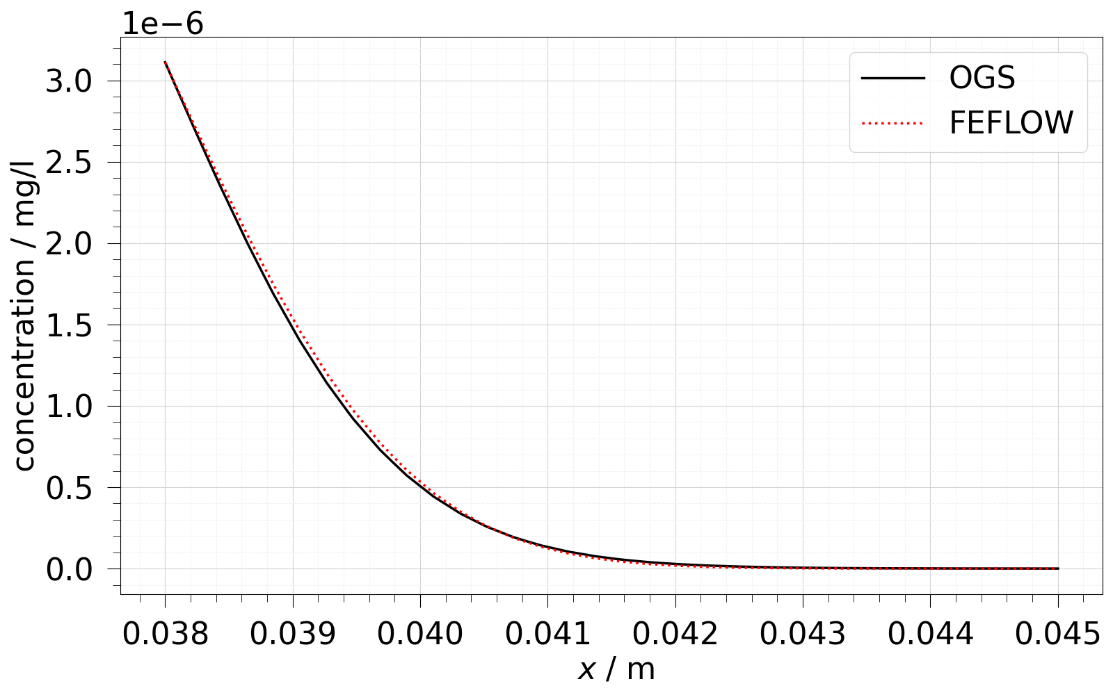

4. Read the last timestep and plot the results along a line on the upper edge of the mesh parallel to the x-axis.
ogs_sim_res = ot.MeshSeries(temp_dir / "2D_CT_model.pvd")[-1]
fig, ax = plt.subplots(1, 1, figsize=(16, 10))
pts = [[0.038 + 1.0e-8, 0.005, 0], [0.045, 0.005, 0]]
for i, mesh in enumerate([ogs_sim_res, feflow_model.mesh]):
    sample = mesh.sample_over_line(*pts)
    label = ["OGS", "FEFLOW"][i]
    ot.plot.line(
        sample, concentration, ax=ax, color="kr"[i], label=label, ls="-:"[i]
fig.show()

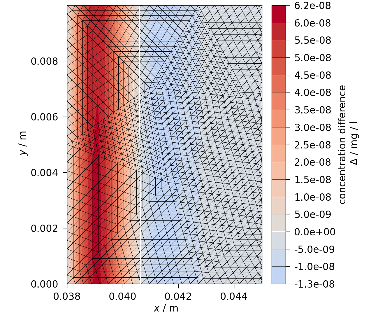

  1. Concentration difference plotted on the mesh.
diff = ot.mesh.difference(feflow_model.mesh, ogs_sim_res, concentration)
diff_clipped = diff.clip_box([0.038, 0.045, 0, 0.01, 0, 0], invert=False)
fig = ot.plot.contourf(diff_clipped, concentration.difference, fontsize=20)
fig.show()
plot D feflowlib CT simulation

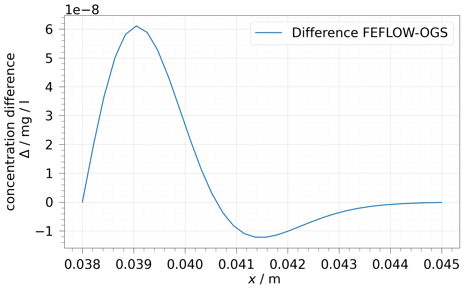

5.1 Concentration difference plotted along a line.
diff_sample = diff.sample_over_line(*pts)
fig = ot.plot.line(
    diff_sample, concentration.difference, label="Difference FEFLOW-OGS"
fig.show()
