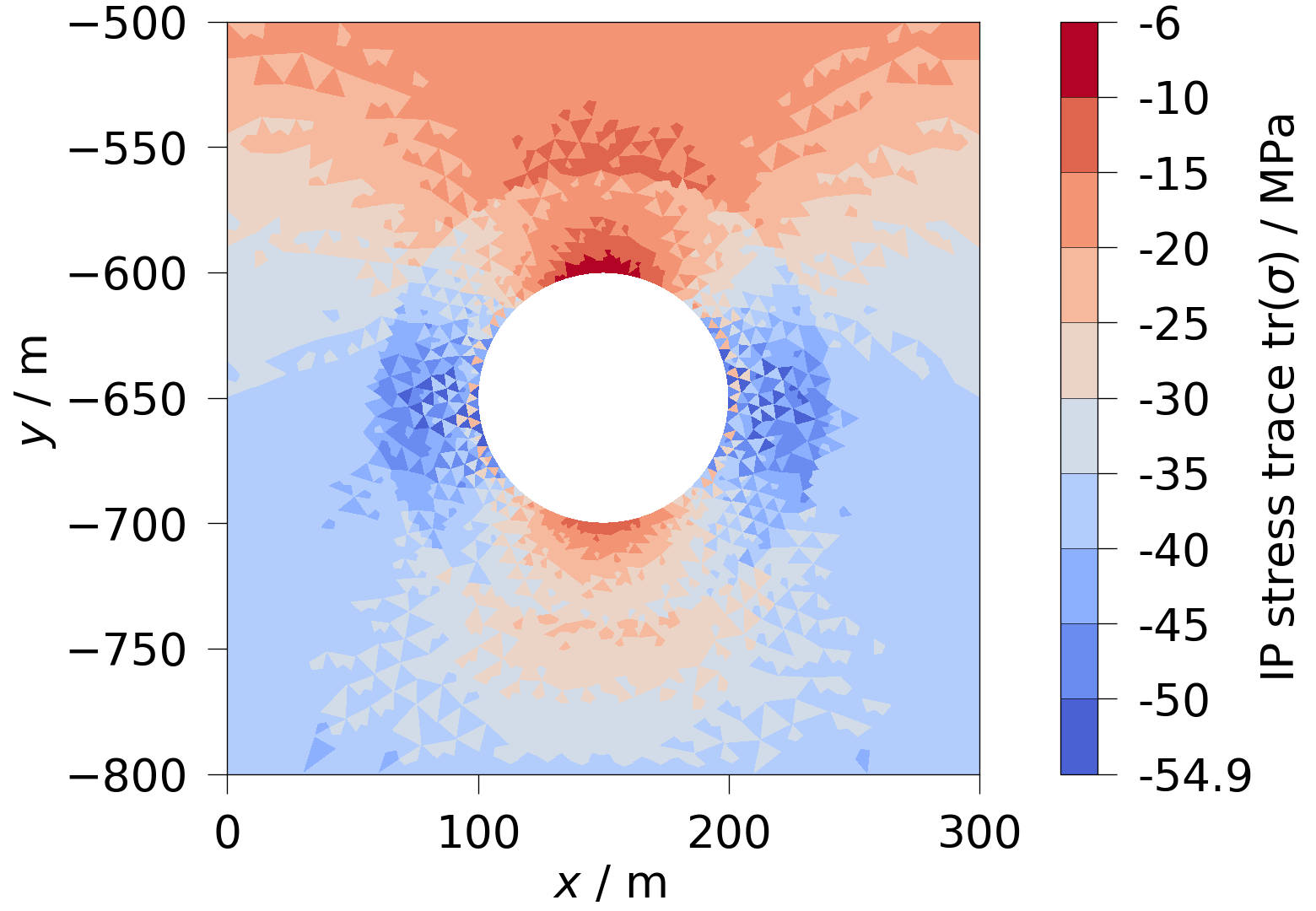

Let’s visualize the trace of the integration point stresses on an artificial mesh where each integration point corresponds to one cell.
sigma_ip = ot.variables.stress.replace(
    data_name="sigma_ip", output_name="IP_stress"
ip_mesh = ot.mesh.to_ip_mesh(mesh)
fig = ot.plot.contourf(ip_mesh, sigma_ip.trace)
fig.show()
plot modify integration point data

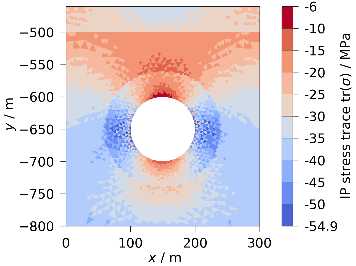

We can see, that the above modifications are reflected in the mesh.
with np.printoptions(precision=2):
    print(ip_data.info)
{'sigma_ip': IPdict(order=2, num_components=4, values=
pyvista_ndarray([[ -7987910.41, -18461460.32, -10186589.92,   2921306.85],
                 [ -7640889.57, -18208899.37,  -9853812.67,   2937028.72],
                 [ -7602079.8 , -18188409.8 ,  -9817763.32,   2940074.05],
                 [-11281262.73, -10831452.68,  -3367376.43,     54694.16],
                 [-11058147.92, -10608337.87,  -3144261.63,     54694.16],
                 [-11228033.93, -10778223.88,  -3314147.64,     54694.16]],
                shape=(6960, 4))),
 'epsilon_ip': IPdict(order=2, num_components=4, values=
pyvista_ndarray([[ 0., -0.,  0.,  0.],
                 [ 0., -0.,  0.,  0.],
                 [ 0., -0.,  0.,  0.],
                 [ 0., -0.,  0.,  0.],
                 [ 0., -0.,  0.,  0.],
                 [ 0., -0.,  0.,  0.]], shape=(6960, 4))),
 'new_scalar': IPdict(order=2, num_components=1, values=
array([0., 0., 0., ..., 0., 0., 0.], shape=(6960,))),
 'new_tensor': IPdict(order=2, num_components=4, values=
array([[1, 1, 1, 0],
       [1, 1, 1, 0],
       [1, 1, 1, 0],
       [1, 1, 1, 0],
       [1, 1, 1, 0],
       [1, 1, 1, 0]], shape=(6960, 4)))}
fig = ot.plot.contourf(ot.mesh.to_ip_mesh(mesh), sigma_ip.trace)
fig.show()

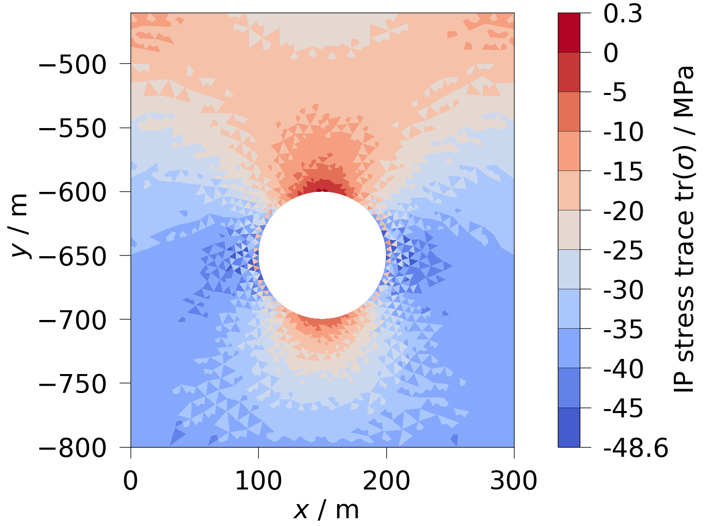

Remove a material group#
The following code recipe removes a material group from the mesh and updates the integration point data accordingly.
modified = mesh.threshold([1, 1], scalars="MaterialIDs")
cell_map = modified.find_containing_cell(ip_cloud.points)
# -1 marks those points, where no cell ws found, i.e. those which got removed.
mask = cell_map[cell_map != -1]
for data in ot.mesh.IPdata(modified).values():
    data.values = data.values[mask]
fig = ot.plot.contourf(ot.mesh.to_ip_mesh(modified), sigma_ip.trace)
fig.show()
