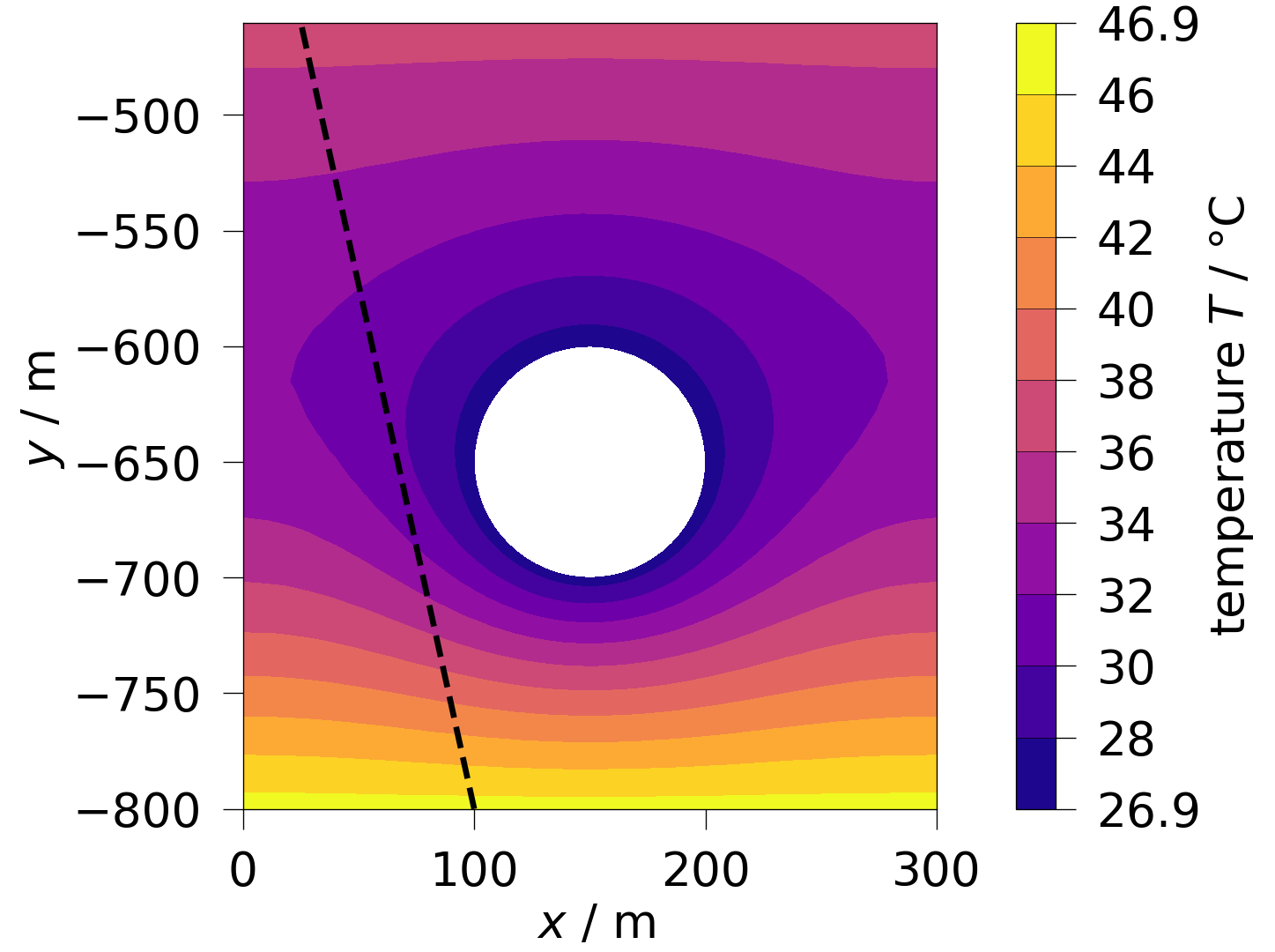

We use the pyvista function sample_over_line and use two points to define the line and get a Mesh with the sampled data. Let’s plot the Mesh and the line together.
sample = mesh.sample_over_line([25, -460, 0], [100, -800, 0])
fig = ot.plot.contourf(mesh, ot.variables.temperature)
ot.plot.line(sample, ax=fig.axes[0], linestyle="--")
fig.show()
plot sample mesh line

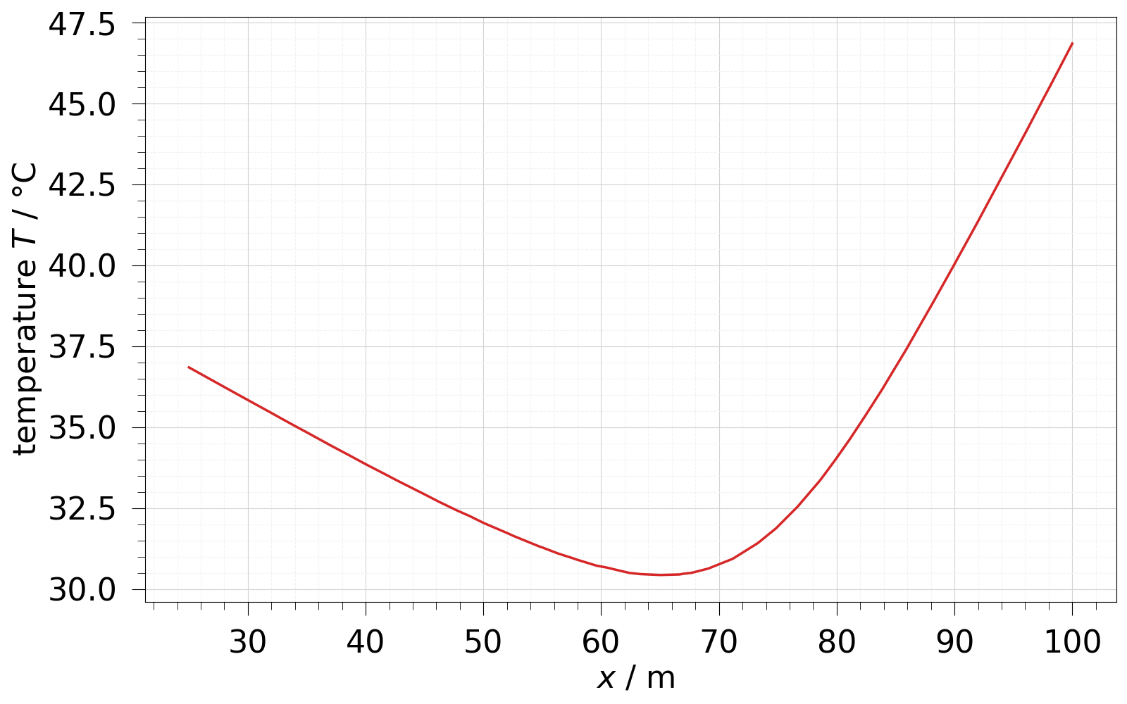

Now we plot the temperature data. The spatial coordinate for the x-axis is automatically detected here.
fig = ot.plot.line(sample, ot.variables.temperature)
fig.show()

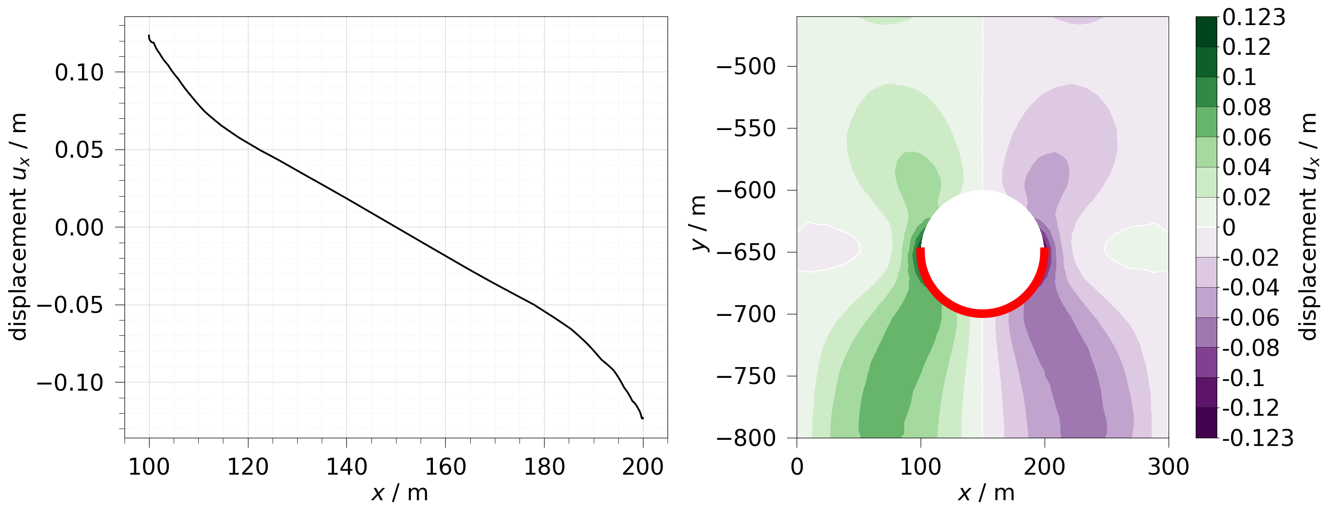

Simple case: circular arc#
With 3 points we can define an arc over which to sample the data. Having the arc directly on a boundary might result in some gaps in the sampled data, thus we extend the arc by a small margin.
sample = mesh.sample_over_circular_arc(
    pointa=[100 - 1e-4, -650, 0],
    pointb=[200 + 1e-4, -650, 0],
    center=[150, -650, 0],
fig, axs = plt.subplots(ncols=2, figsize=[26, 10])
ot.plot.contourf(mesh, ot.variables.displacement["x"], fig=fig, ax=axs[1])
ot.plot.line(sample, ax=axs[1], lw=3, color="red")
ot.plot.line(sample, ot.variables.displacement["x"], ax=axs[0])
fig.show()

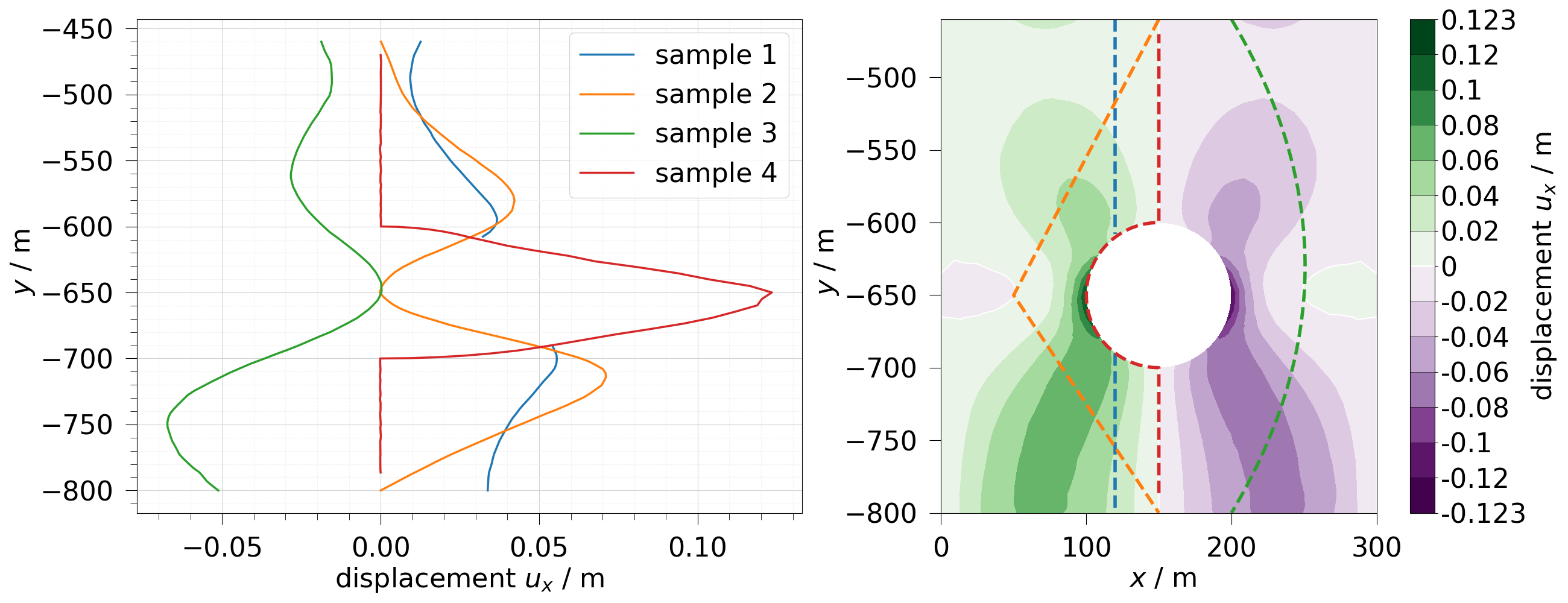

Now we plot all samples for comparison.
u_x = ot.variables.displacement["x"]
ot.plot.contourf(mesh, u_x, fig=fig, ax=axs[1])
for i, sample in enumerate([sample_1, sample_2, sample_3, sample_4]):
    c = f"C{i}"  # cycle through default color cycle
    ot.plot.line(sample, ax=axs[1], linestyle="--", color=c)
    ot.plot.line(sample, u_x, "y", ax=axs[0], label=f"sample {i + 1}", color=c)
fig.show()
