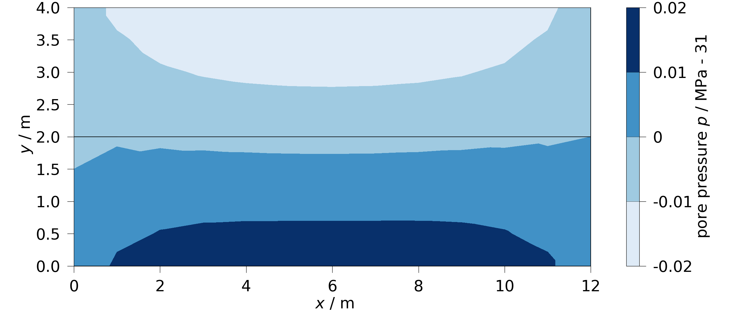

Intermediate plot#
If the simulation is paused or interrupted, you can inspect the current state of the mesh. You are free to adapt the mesh and continue the simulation as shown in while loop above. Let us just plot the pressure field.
fig = ot.plot.contourf(domain_mesh, "pressure")
fig.show()

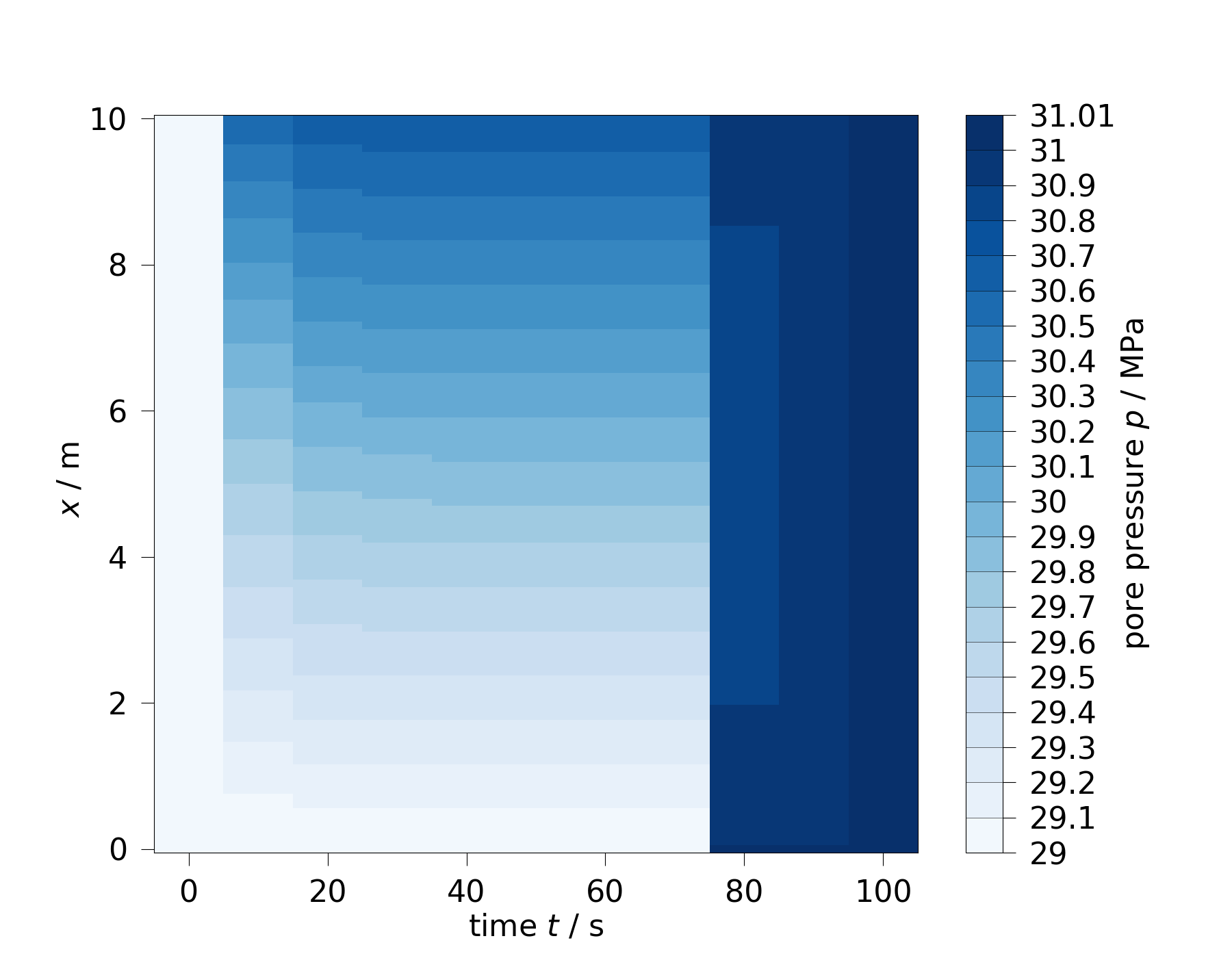

Visualization#
# We visualize how the dynamically updated boundary conditions affected the pressure field.
# Changes in boundary conditions can be clearly observed.
ms = sim.meshseries
# !paraview {ms.filepath} # for interactive exploration
# Time slice over x
points = np.linspace([0, 1, 0], [10, 1, 0], 100)
ms_probe = ms.probe(points, "pressure")
fig = ms_probe.plot_time_slice("time", "x", variable="pressure", num_levels=20)
fig.show()
