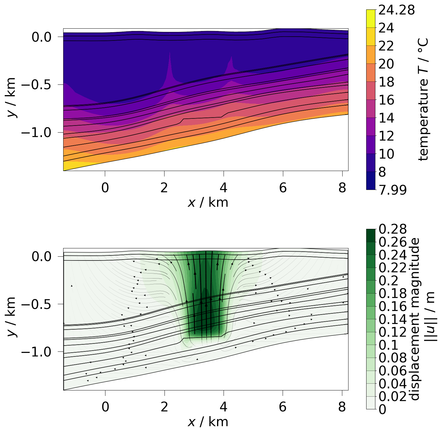

It is possible to plot various variables in different subplots of the same figure:
fig, ax = plt.subplots(2, 1, figsize=(15, 15))
ot.plot.contourf(
    meshseries.mesh(0), ot.variables.temperature, fig=fig, ax=ax[0]
ot.plot.contourf(
    meshseries.mesh(1), ot.variables.displacement, fig=fig, ax=ax[1]
fig.show()
plot with custom fig ax

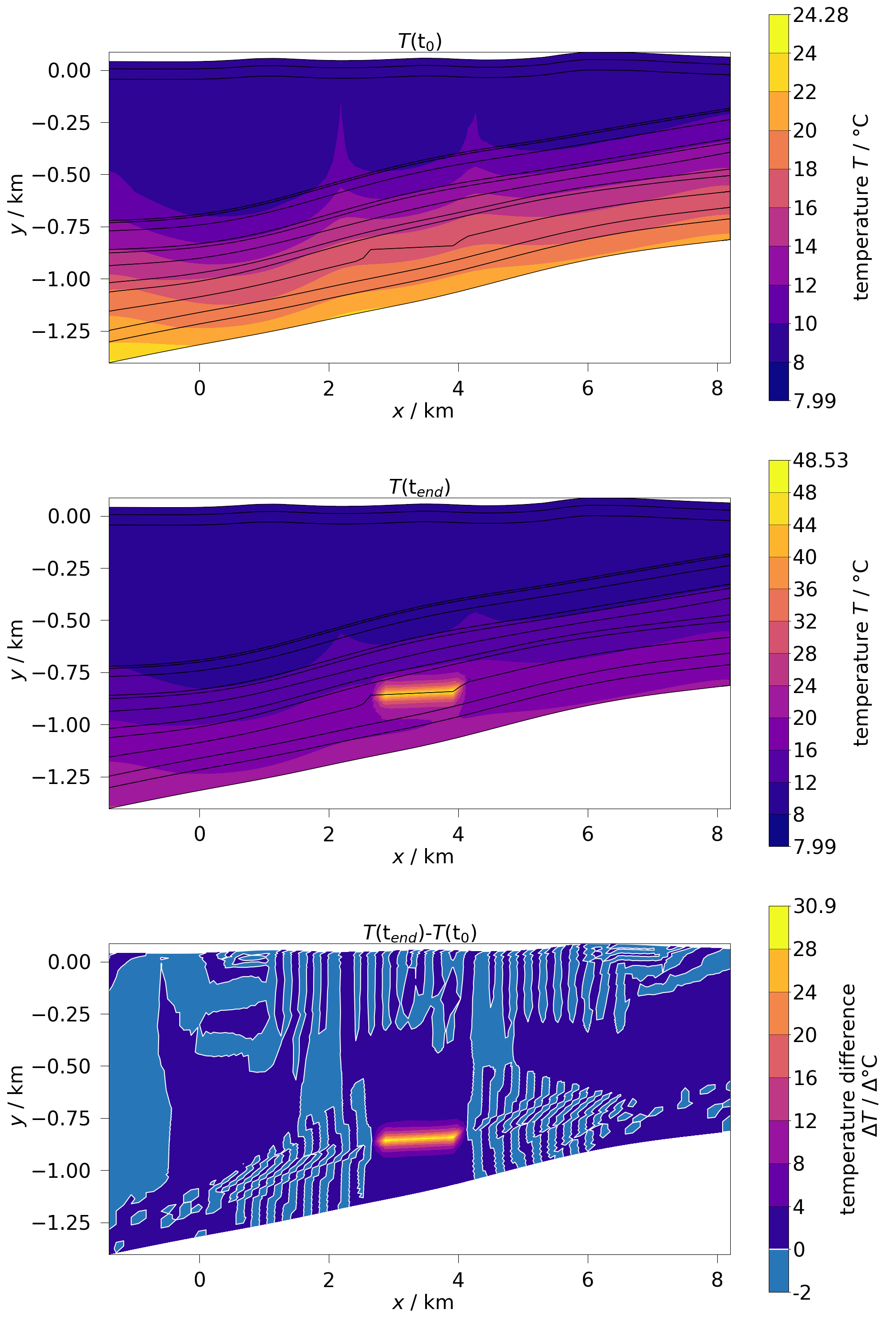

Plot two time steps and their difference#
We can use the same approach to plot the difference between different time steps can be plotted. Color bars can be drawn automatically, if user provides both Figure and Axes objects:
fig, ax = plt.subplots(3, 1, figsize=(20, 30))
ot.plot.contourf(
ot.plot.contourf(
    meshseries.mesh(1), ot.variables.temperature, fig=fig, ax=ax[1]
diff_mesh = ot.mesh.difference(
    meshseries.mesh(1), meshseries.mesh(0), ot.variables.temperature
ot.plot.contourf(diff_mesh, ot.variables.temperature, fig=fig, ax=ax[2])
ax[0].set_title(r"$T(\mathrm{t}_{0})$", fontsize=32)
ax[1].set_title(r"$T(\mathrm{t}_{end})$", fontsize=32)
ax[2].set_title(r"$T(\mathrm{t}_{end})$-$T(\mathrm{t}_{0})$", fontsize=32)
fig.show()
$T(\mathrm{t}_{0})$, $T(\mathrm{t}_{end})$, $T(\mathrm{t}_{end})$-$T(\mathrm{t}_{0})$
