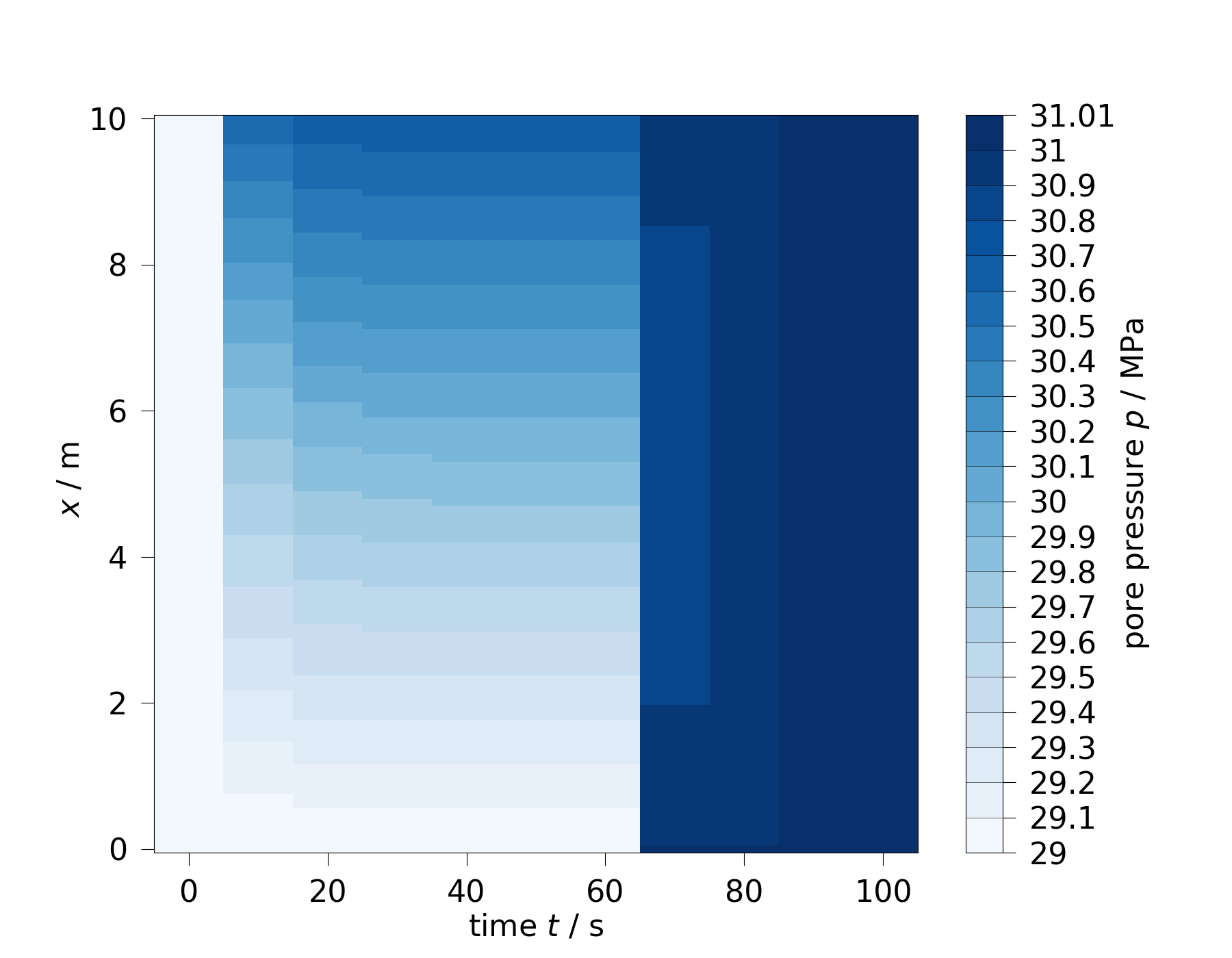

Visualization
ms3 = ot.MeshSeries(sim_output / model.project.meshseries_file())
# !paraview {ms.filepath} # for interactive exploration
# Time slice over x
points = np.linspace([0, 1, 0], [10, 1, 0], 100)
ms_probe = ms3.probe(points, "pressure")
fig = ms_probe.plot_time_slice("time", "x", variable="pressure", num_levels=20)
fig.show()
