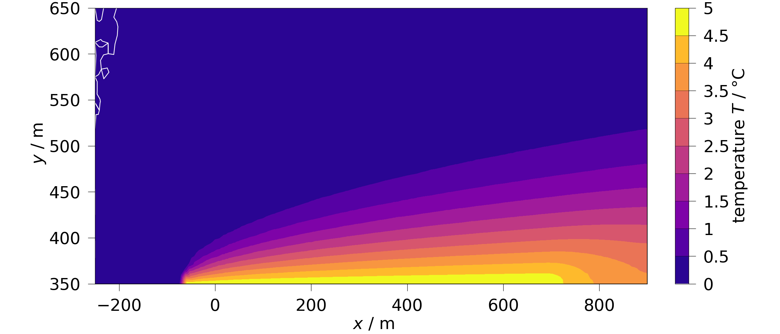

  1. Plot the temperature simulated in FEFLOW on the mesh, and print information about the mesh.
feflow_temperature = ot.variables.temperature.replace(data_name="P_TEMP")
ot.plot.contourf(feflow_model.mesh, feflow_temperature)
print(feflow_model.mesh)
plot F feflowlib HT simulation
UnstructuredGrid (0x7f0df3c79d80)
  N Cells:    6260
  N Points:   3228
  X Bounds:   -2.500e+02, 9.000e+02
  Y Bounds:   3.500e+02, 6.500e+02
  N Arrays:   33

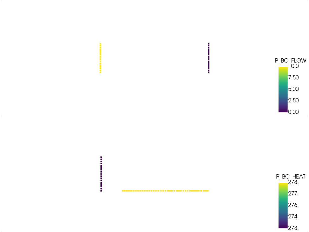

  1. Extract the subdomains.
subdomains = feflow_model.subdomains
# Since there can be multiple boundary conditions in the subdomains, they are plotted iteratively.
plotter = pv.Plotter(shape=(len(subdomains), 1))
for i, (name, boundary_condition) in enumerate(subdomains.items()):
    # topsurface refers to a cell based boundary condition.
    if name != "topsurface":
        plotter.subplot(i, 0)
        plotter.add_mesh(boundary_condition, scalars=name)
        plotter.view_xy()
plotter.show()

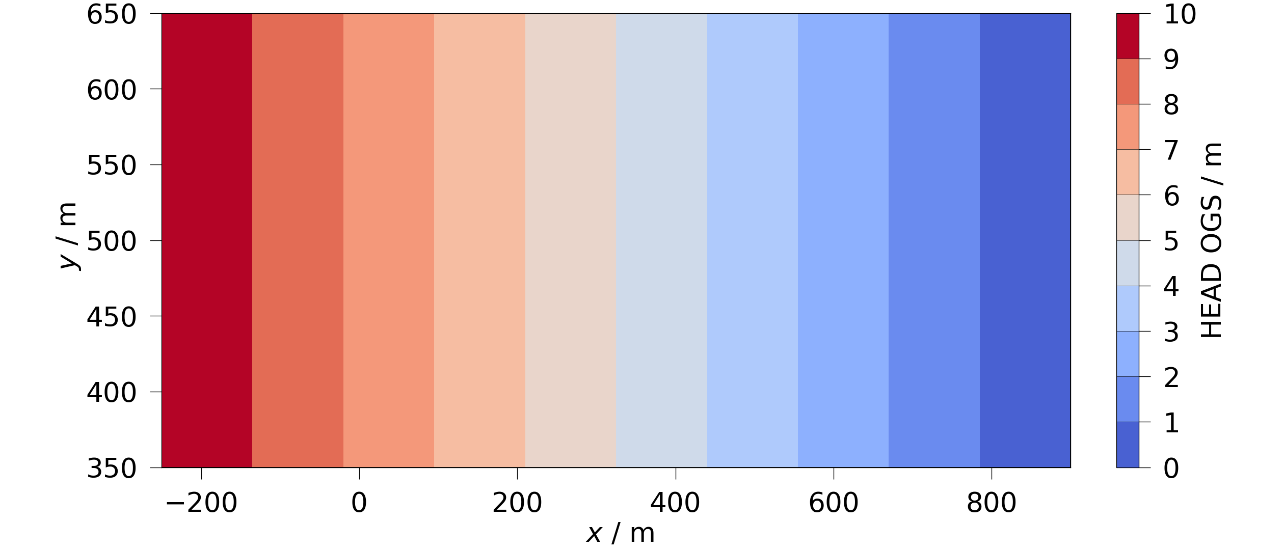

# Plot the hydraulic head/height, which was simulated in OGS.
hydraulic_head = ot.variables.Scalar(
    data_name="HEAD_OGS", data_unit="m", output_unit="m"
ot.plot.contourf(ogs_sim_res, hydraulic_head)
<Figure size 2520x1080 with 2 Axes>

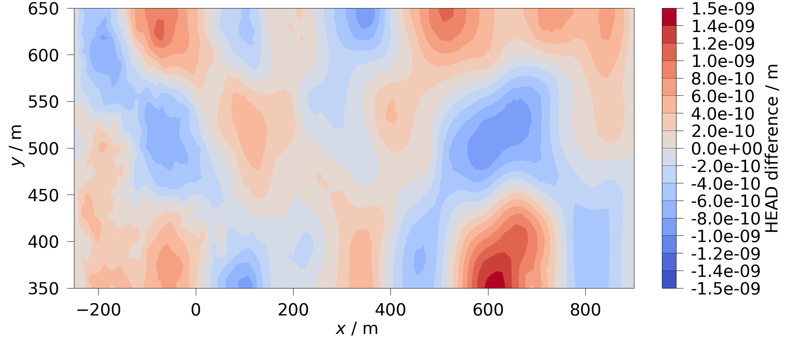

  1. Plot the difference between the FEFLOW and OGS simulation.
feflow_model.mesh["HEAD"] = feflow_model.mesh["P_HEAD"]
ogs_sim_res["HEAD"] = ogs_sim_res["HEAD_OGS"]
# Plot differences in hydraulic head/height.
diff_mesh = ot.mesh.difference(feflow_model.mesh, ogs_sim_res, "HEAD")
hydraulic_head_diff = ot.variables.Scalar(
    data_name="HEAD_difference", data_unit="m", output_unit="m"
ot.plot.contourf(diff_mesh, hydraulic_head_diff, vmin=-1.5e-9, vmax=1.5e-9)
/builds/ogs/tools/ogstools/docs/examples/howto_conversions/plot_F_feflowlib_HT_simulation.py:69: RuntimeWarning: Only one input mesh defines a spatial unit. Assuming both meshes use the spatial unit `1 m`

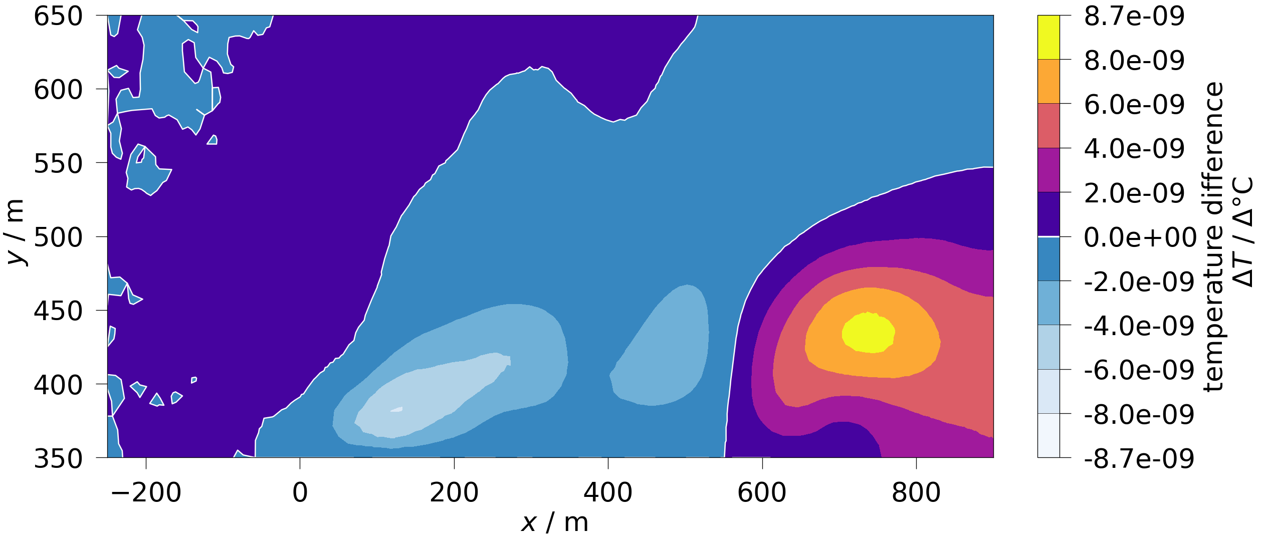

Plot differences in temperature.
feflow_model.mesh["temperature"] = feflow_model.mesh["P_TEMP"]
# Plot differences in temperature.
    feflow_model.mesh, ogs_sim_res, ot.variables.temperature
ot.plot.contourf(
    diff_mesh, ot.variables.temperature.difference, vmin=-8.7e-9, vmax=8.7e-9
/builds/ogs/tools/ogstools/docs/examples/howto_conversions/plot_F_feflowlib_HT_simulation.py:78: RuntimeWarning: Only one input mesh defines a spatial unit. Assuming both meshes use the spatial unit `1 m`
