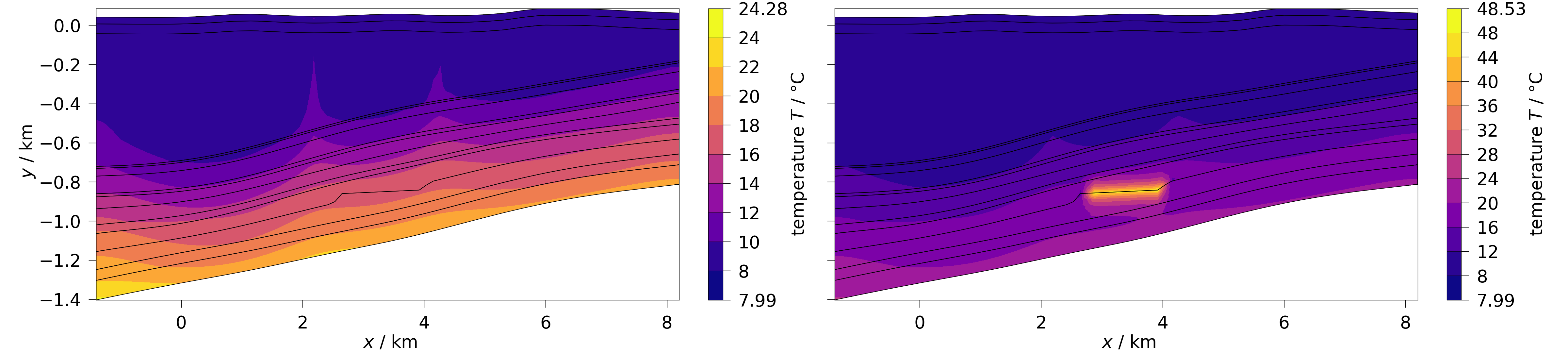

If you pass multiple meshes to ogstools.plot.contourf() by default both x and y axes will shared. Thus, only the outer axes get axes labels and tick label.
fig = ot.plot.contourf([mesh_0, mesh_1], temperature)
fig.show()
plot shared axes

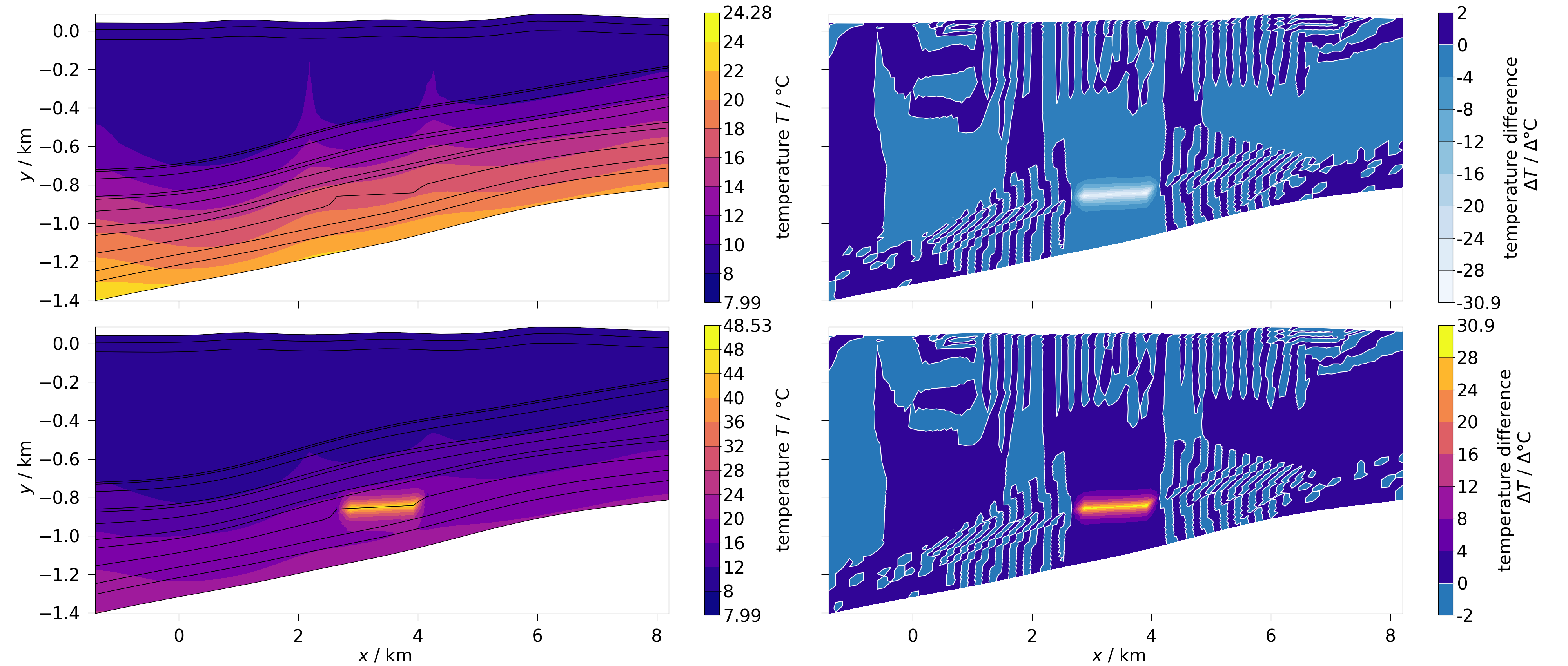

On user defined figure and axis the axis belonging to specific subplot has to be passed.
fig, axs = plt.subplots(2, 2, figsize=(40, 17), sharex=True, sharey=True)
diff_a = ot.mesh.difference(mesh_0, mesh_1, temperature)
diff_b = ot.mesh.difference(mesh_1, mesh_0, temperature)
ot.plot.contourf(mesh_0, temperature, fig=fig, ax=axs[0][0])
ot.plot.contourf(mesh_1, temperature, fig=fig, ax=axs[1][0])
ot.plot.contourf(diff_a, temperature, fig=fig, ax=axs[0][1])
ot.plot.contourf(diff_b, temperature, fig=fig, ax=axs[1][1])
fig.show()
plot shared axes
