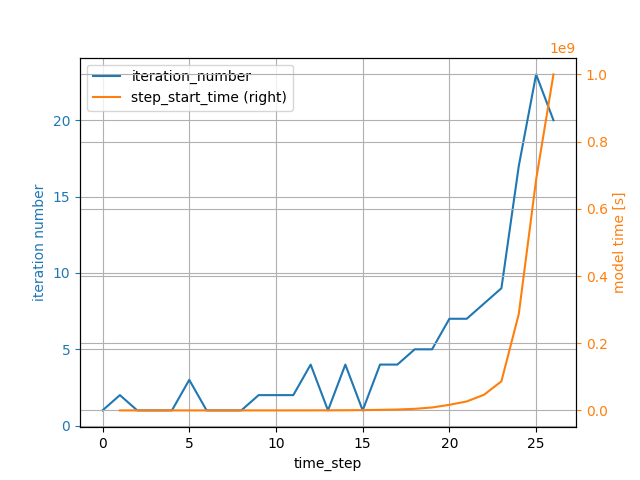

Pandas to plot#
You can directly use plot <https://pandas.pydata.org/pandas-docs/stable/reference/api/pandas.DataFrame.plot.html>`_ from pandas.
ax = df_ts_it.plot(
    y="iteration_number", xlabel="time_step", grid=True, legend=False
df_ts_it.plot(
    y="step_start_time",
    xlabel="time_step",
    ax=ax,
    secondary_y=True,
    grid=True,
    legend=False,
ax.set_ylabel("iteration number")
ax.yaxis.label.set_color("C0")  # colour matches the left line
ax.tick_params(axis="y", colors="C0")
ax_right = ax.right_ax
ax_right.set_ylabel("model time [s]")
ax_right.yaxis.label.set_color("C1")
ax_right.tick_params(axis="y", colors="C1")
lines, labels = ax.get_legend_handles_labels()
lines2, labels2 = ax_right.get_legend_handles_labels()
ax.legend(lines + lines2, labels + labels2, loc="upper left")
ax.get_figure().show()
plot 100 logparser intro
